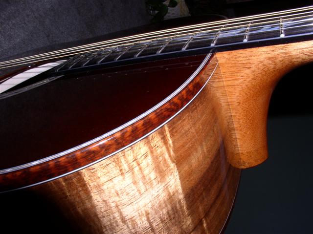

I'm sure others have done this. But I have not seen it yet. I had some maple and ebony veneer just waiting for me to do something with, so I made plywood.
I laminated them under the headstock.
PostPosted: Tue Nov 07, 2006 5:26 pm
Cool! Can't wait to see it under finish!
PostPosted: Tue Nov 07, 2006 5:36 pm
Yep...I do the same especially on slotheads...it really looks great in the cutouts as well as in the ramps.
Looking good, Steve!

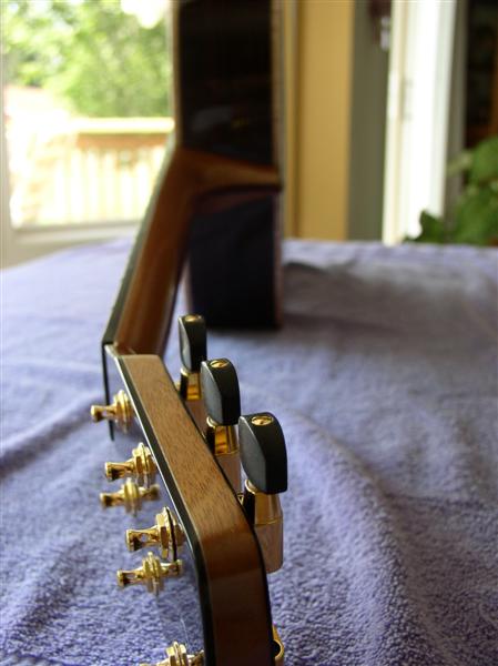

I laminated this on my maple neck a couple weeks ago. Started shaping it last night.
It certainly worth mentioning things that! I always like the look of those layers on the peghead.
-j.

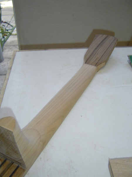

I do mine slightly differently, in that I inlay a thicker piece of the wood on the rear. Same wood as the headplate, usually the same wood as the B&S, I like to keep the number of different woods used down. So the Back/sides/tail graft/headplate/rosette, etc are the same wood.
This one is Cherry neck wood with walnut head and back plate, it only half finished here.
